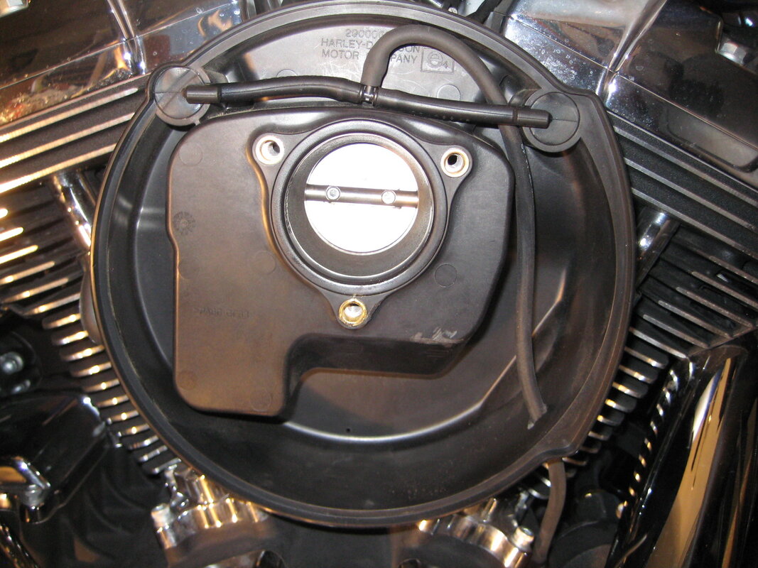

I have a 2016 Triglide,
What I have done;
-de-cat header pipe
-re-route tubes in breather as such
IMG_1202.JPG ....hope borrowing this pic is OK
Gave thought to drilling a couple of small holes in back of breather plate for more air,not sure yet.And switching to a K&N filter
Now for the question
Will this benefit my bike?
Thanks for any and all response's
