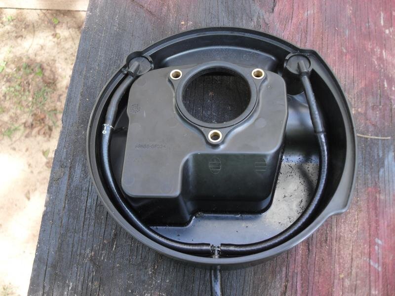

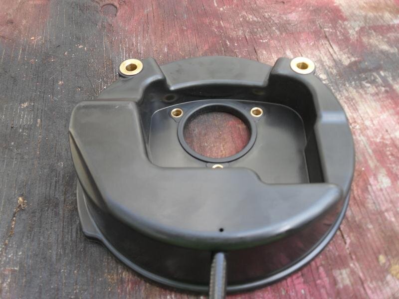

I went a little different route...used 3/8 fuel line and two straight hose barbs and the T barb to bring them back together...used a dremel to reroute the hoses downward...This is the stock setup...
Rick,since I'm kinda new at some of this,are we correct to assume you fabbed your own breather system here?
Where did you utilize the dremel?

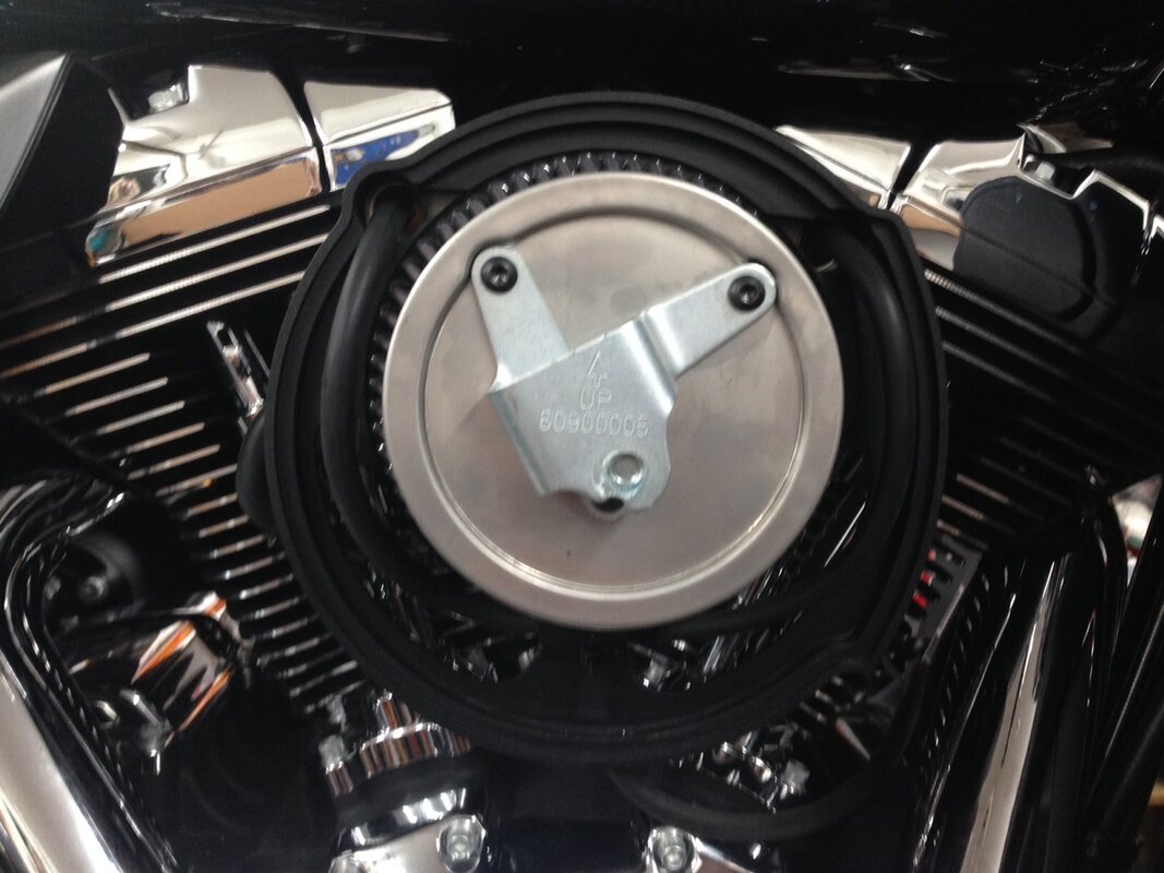

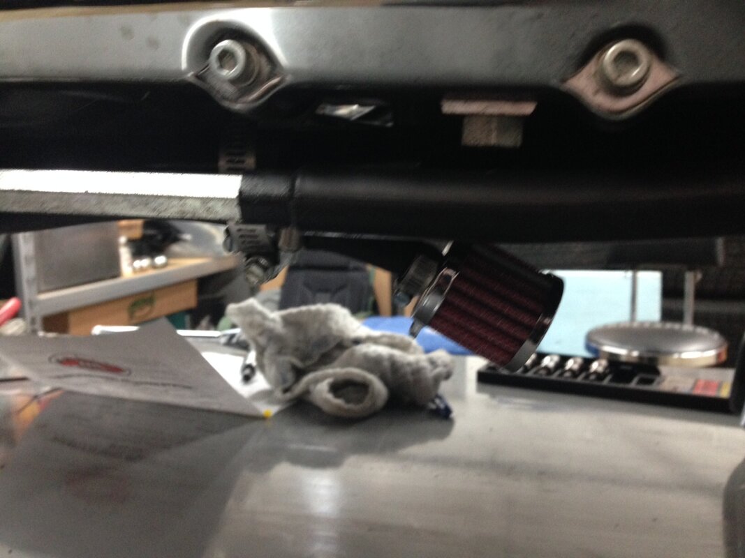

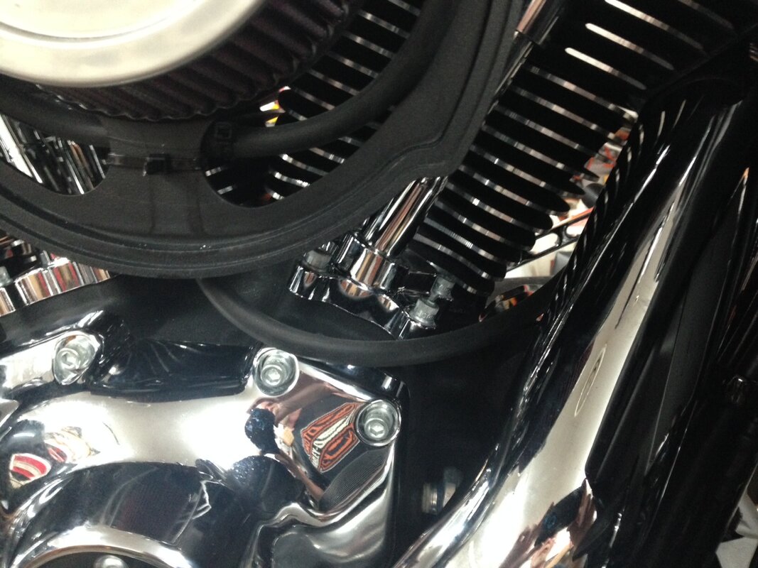

Last night I Installed the Discrete Breather on the Fuel Moto Pro Billet air cleaner.Attached are some pics showing the routingView attachment 29352View attachment 29353View attachment 29355
Update .Since the original istall I pulled the cover and one of the hoses came off the breather bolt. I used a little 3M super weatherstrip adhesive on the nipple and I believe that solved the problem. I also filled the channel where the hose used to run with high temp copper silicone to prevent any unfiltered air from getting in.
Clint I should have took a before pic...mine is a stock 14-15 air cleaner...
if you look close at top of the hoses and to the left you will see a cut out for the hose to go left and the other one to go right for the stock setup...they would join a T barb then another short hose into the air filter...
I used the dremel to make new cutouts to go downward...
