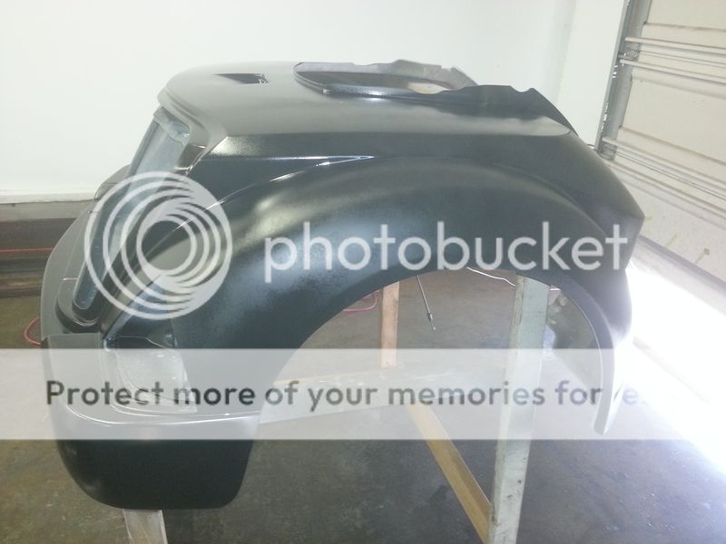

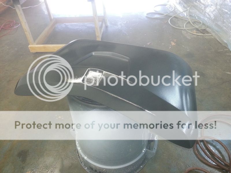

Spraying sealer
[FONT=Verdana, Arial, Tahoma, Calibri, Geneva, sans-serif][/FONT]
After sealer is applied there is 1hr wait ,then the base coat can be applied

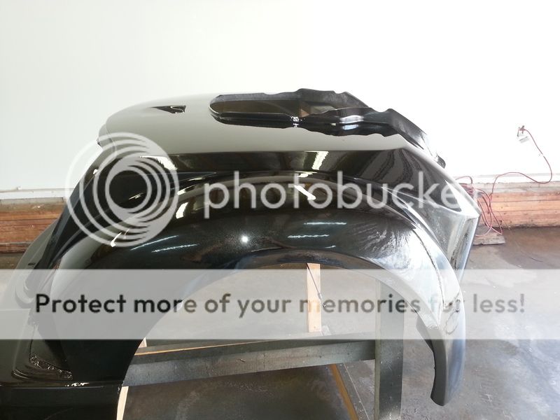

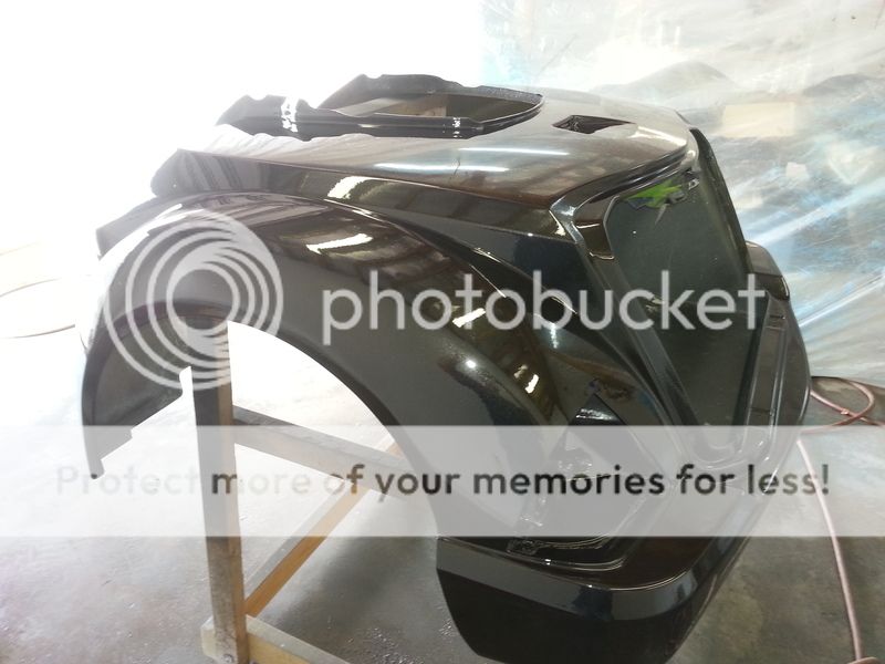

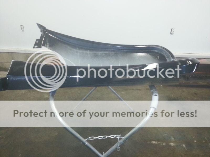

I got the paint applied yesterday. Not the best I have done but certainly not the worst I have done.A little sanding and buffing to do.pics will be on there way.
Man you do good work Clint! The body looks great!
Thanks,Its not perfect,but will do for now.The paint is still to green to buff.That will have to wait a few more days.I use to use a additive called supercharger,it would cure the paint in 6 hrs.not sure if that's availibale any more.I didn't realize until my brother and I were talking ,it's been over 5 years since I painted anything.I hope to have it all together tomorrow.
Very impressive. I am a pretty good mechanic but no good at all on any kind of paint work. Looks great and can't wait to see the finished product.

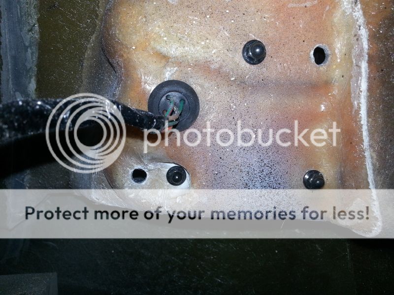

When I put the left tail light in the body I had a problem with the lower left bolt.There was not enough room for the nut the thread on,so I took a die grinder and cut away some of the fiberglass to make room

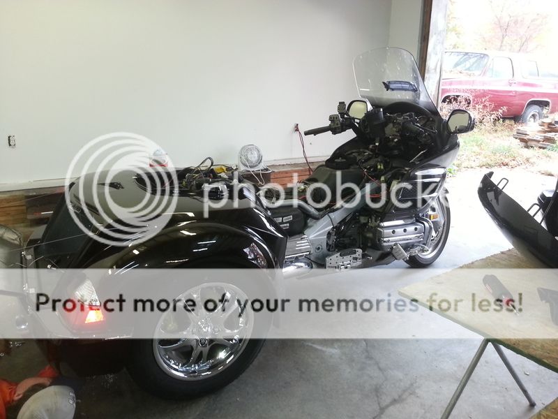

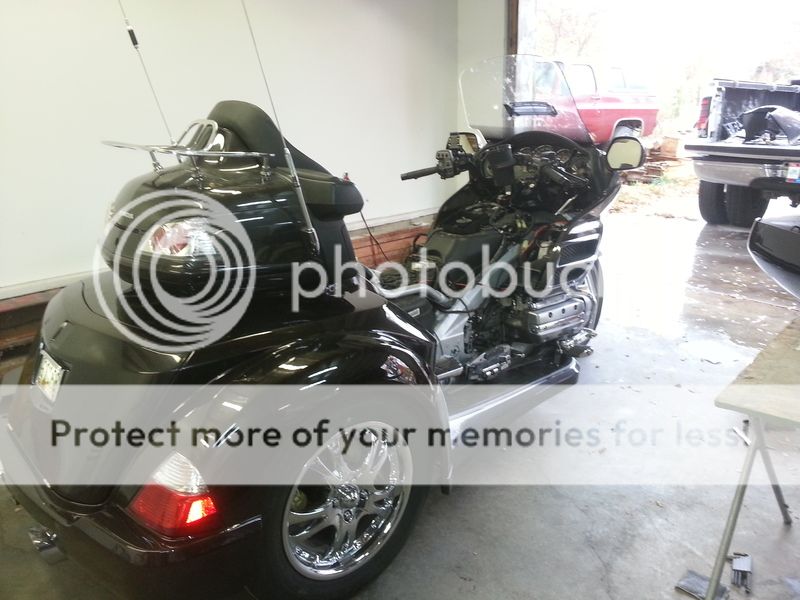

I have a few things to finish up but it is nearly done.Its not been washed up yet.
When is the maiden voyage Clint?
Not sure ,but getting close,I have a few things to do yet,Maybe a days work,Rake kit,carpet kit,adjust latch and get the release working,door seal,extra fuel tank fill and vent lines need hooked to the fill spout on fender, need to buff the paint and clean the whole bike up.These things could go fast or could be a fight to get right.

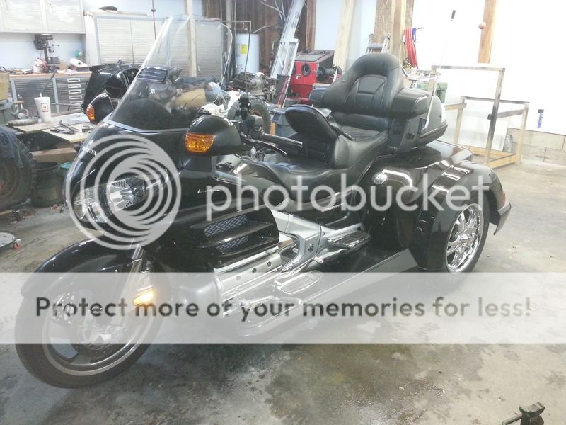

Things went much better this evening.I did stop before it was complete,but not much left to do,just the Tupperware around the instrument cluster ,front fender,and seat .Should finish it tomorrow evening.
