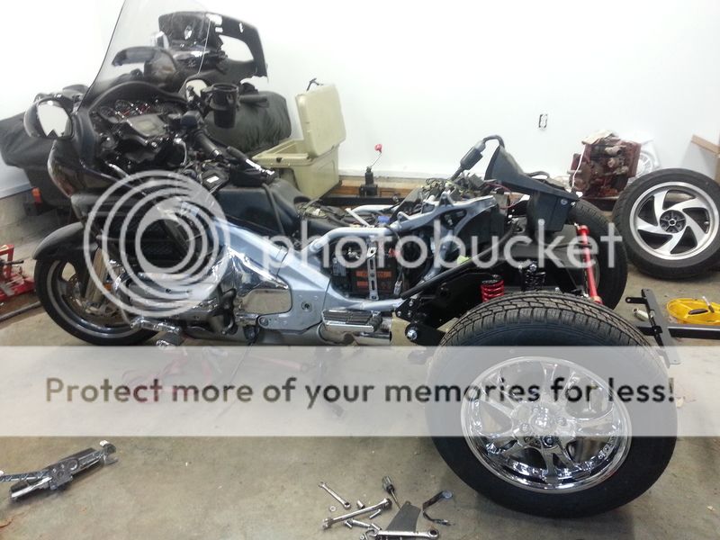

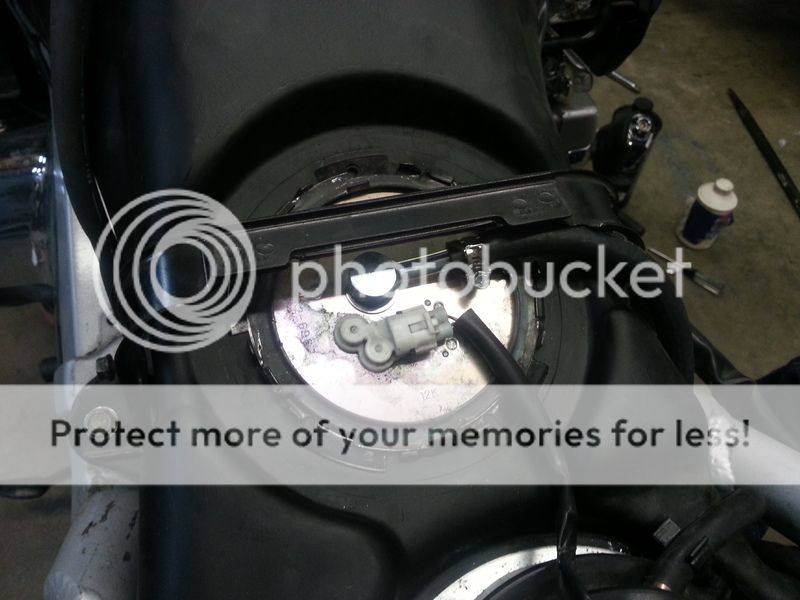

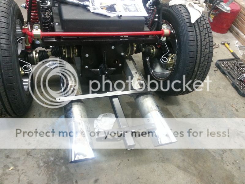

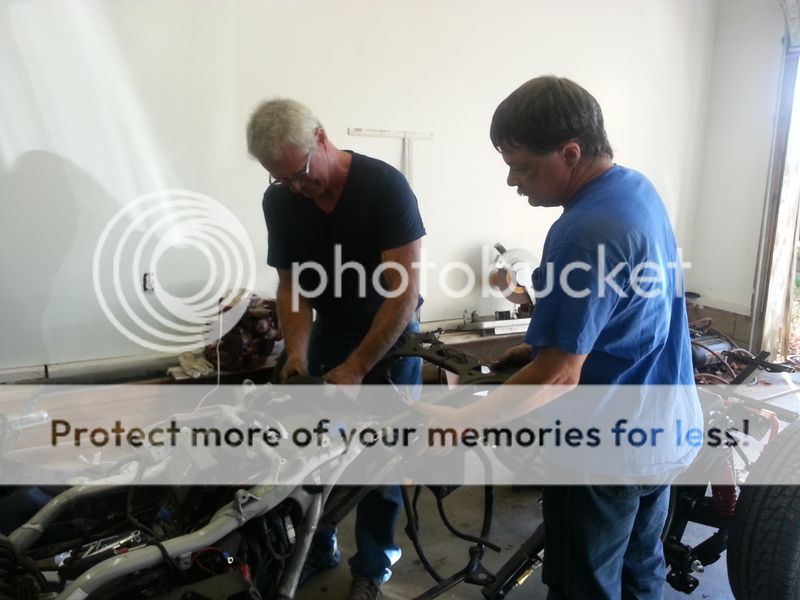

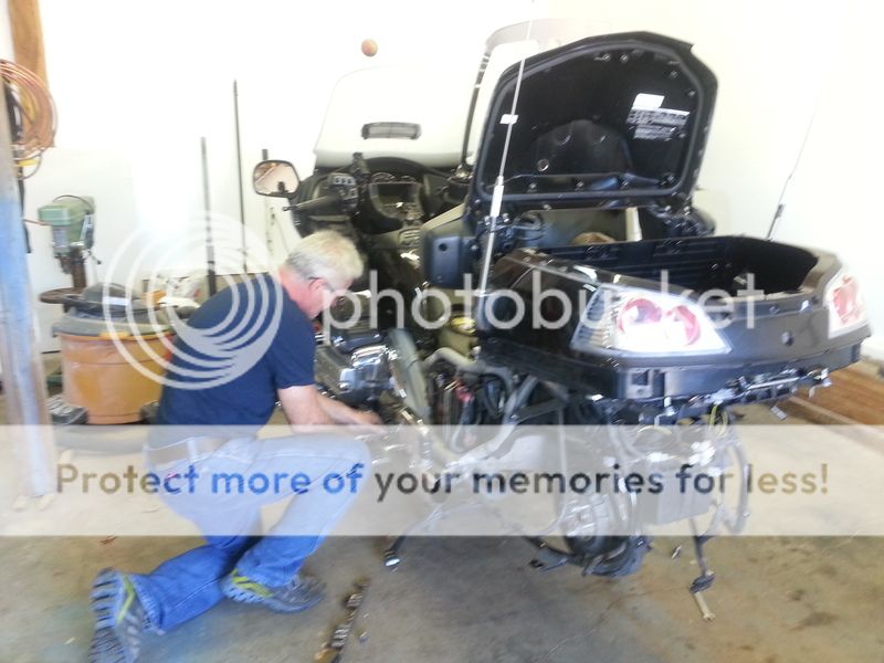

I have done a few things extra along the way on this project. Or I should say done a little more work than I would have to.I pulled the gas tank off , and the top shelter off, and a few other things that don't have to be done.With the gas tank out I had more room to get to the shock and brake lines.the shock can be unbolted without removing the tank and brake lines can be done from the side and bottom. The top shelter is not to hard to get off so I just got it out of my way, but the work around it can be done with it on. I will be doing the rake as well so I won't have to work around it when I get that far along.
I have been trying to post general pics as I go.If any one wants a certain pic or have a ? Please ask, I will try to take the pic that you want to see or answer your ? The best I can.This is my 1st trike build so I am learning as I go

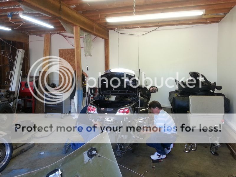

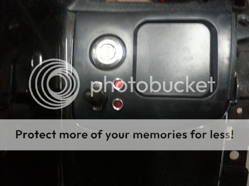

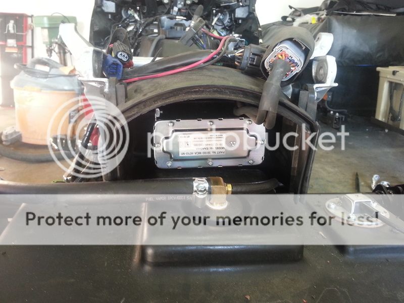

I got a few things done this evening,but not much to take pics of.I put the fuel switch and lights in the shelter,pulled the wires from the relay to where they will hook up to the on and off switch for the transfer pump,and hooked the wire up to the fuse box.I also hooked up the vent hose for the fuel tank and cut the tour pack bracket .This is the only modification that has to be done.The saddle bag frame has to be cut and removed from the bracket .I need to get some pics of this.

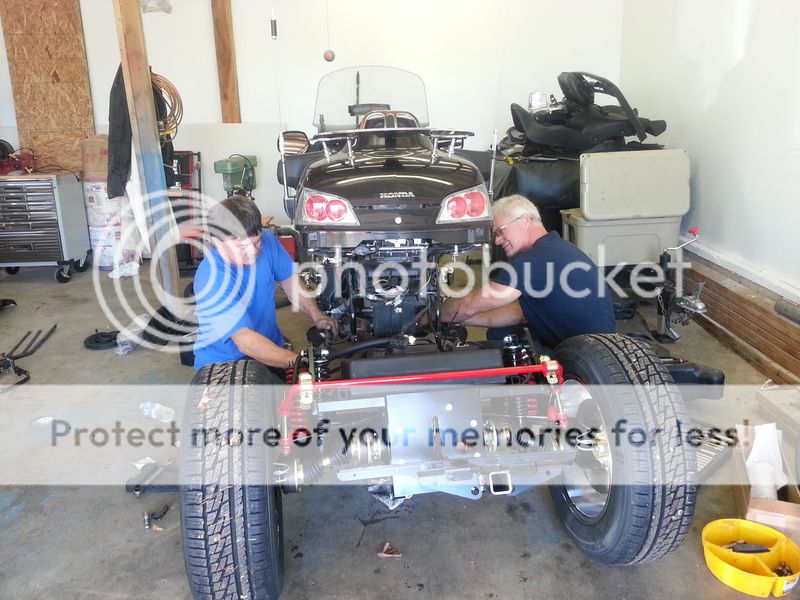

Thanks for keeping us updated Clint. For anyone that has never before done a trike conversion, it is a tedious process, but with the right tools and some decent mechanical skills, it's doable.
When most first timers are finished, I usually hear something like: "Now I know why it costs so much to have a dealer do the conversion. It's worth every penny!"

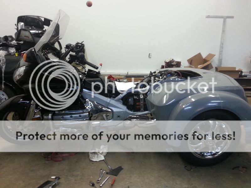

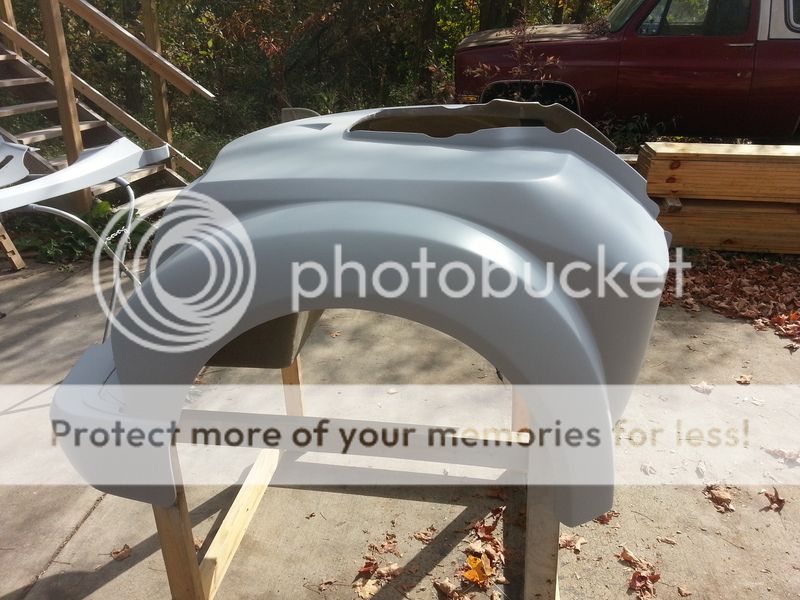

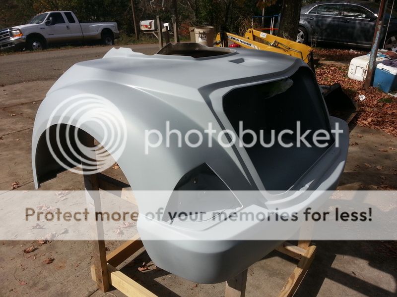

I did a test fit of the body to check for fit.There is more to do including paint before is ready to both bolted on.
it is a little longer than a stock wing,but is what road smith offers.Many of the trike kits are longer than stock.Motortrike is shorter.The longer trikes get the corider in front of the rear tires,they claim a better ride.

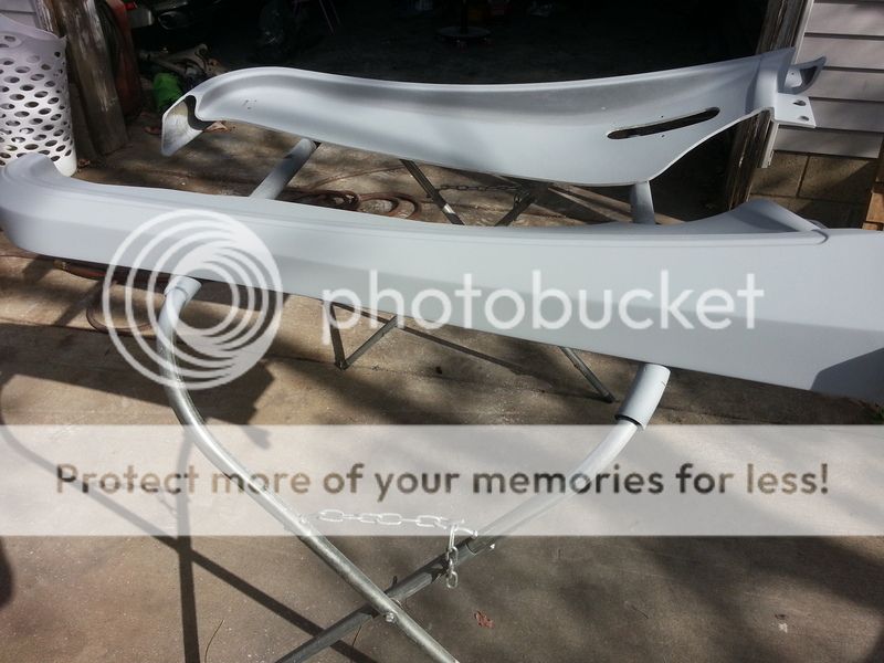

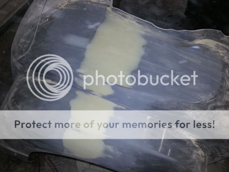

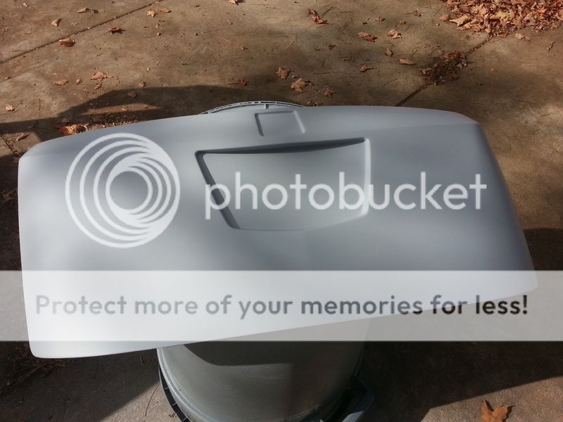

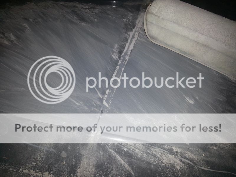

Today I started prepping the body for primer.There is a seam that has to be worked down after the body comes out of the mold

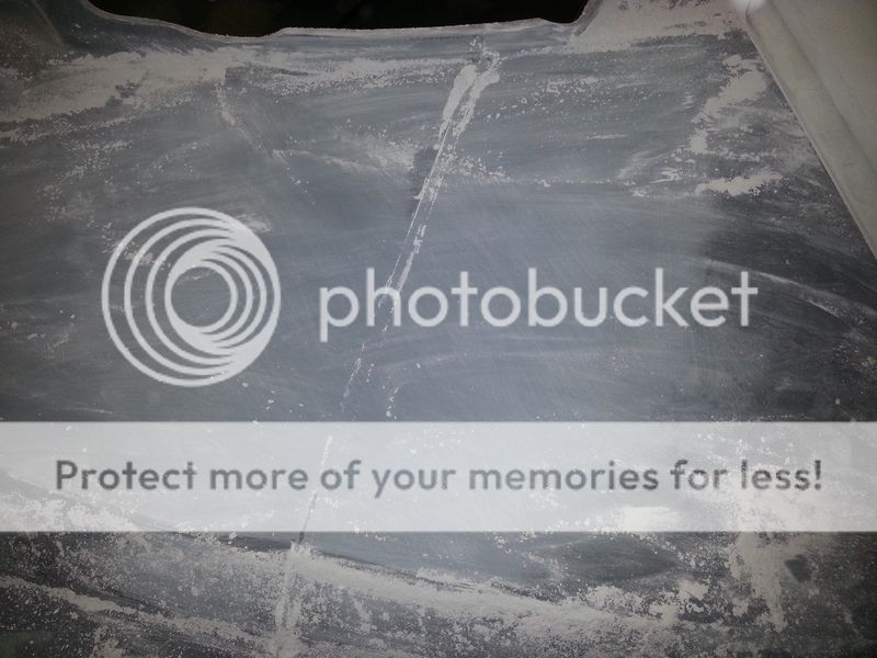

This seam is on both sides of the body
These body's require a lot of sanding to smooth out for paint.I have spent the most time and work on sanding and prep work on the body,than the rest of the work I have done on the build.I have just a little more sanding before primer is applied,then I get to sand again for paint.My big compressor blew up so I am doing all the sanding by hand,all the while my air file board and DA sander are laying in my tool box.Did I mention I have been sanding a lot.
Working the seams doesn't go quick hand sanding Clint. I'd be looking at renting a compressor.
I think filling the seams, sanding, prepping and sealing the body the body for final paint is probably close to half the cost of the factory paint job.
And that prep work is what gives that WOW to the finished paint. You don't get the WOW without that hard prep. Sorry about the compressor. Like Zook says maybe renting one is an option.

I am old school when it comes to final sanding for paint.I still wet sand.Its not done much any more,every one dry sands.I did get all the wet sanding done and it is ready for paint.
