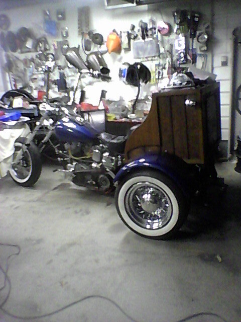

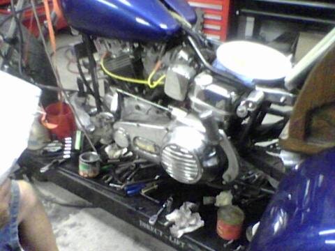

I figured a good compression on a hawg at 9 to 1 or 9.5 to 1 maybe, with cnc head porting stainless valves roller tip rockers adj pushrods, solid lifters, and a cam to match, oh and a bore job, maybe make a 88 inchers pull a trike, ? maybe, ? jus one Ive got on the table eyeballing, (93flhtc) I still think a v rod would be great, (kill the heat) too bad no lower end, that and the mid range is where i live. best to ya.:cool:trike side shot with v8 hubcap.jpgTrike side pic working on it.jpg
1969 Harley police motor, yep original numbers.`This my trike i built in 1975 4 time show winner with a different paint job, and a hand made box from ash paneling by a cabinet maker, my neighbor, at that time.

I figured a good compression on a hawg at 9 to 1 or 9.5 to 1 maybe, with cnc head porting stainless valves roller tip rockers adj pushrods, solid lifters, and a cam to match, oh and a bore job, maybe make a 88 inchers pull a trike, ? maybe, ? jus one Ive got on the table eyeballing, (93flhtc) I still think a v rod would be great, (kill the heat) too bad no lower end, that and the mid range is where i live. best to ya.:cool:View attachment 30616

Sharp looking trike you have there.

Roller rockers are only needed when you get into the .600 and larger lift cams, most of the bolt in cams people use don't need them.
Thank you kind sir, built from 75 to 77, custom box and paint at that time, 4 time show winner. 14yrs in hibernation, now out and went back an pulled the 4spd and put a Sputhe 5spd tranny in her, then the Bendix took a dive, this weekend fix it, then off the table to test it for a bit, then short rides till i trust the process. Living proof they're never done.
