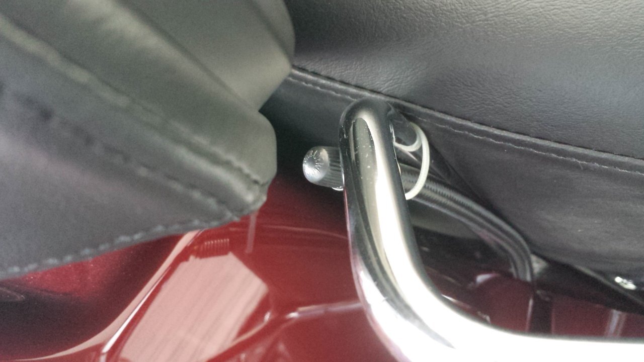

To air up the suspension on my 2015 trike, you have to remove the cover then attach your pump. Why not install a 12 inch air hose to the input and run it outside so the cover doesn't have to be taken off each time. Has anyone done this?
I check the air every few months, And it stays right where it was the last time I checked.
So I see no reason to Rube Goldberg the hose.. But that's just me' If you can rig something up and that will make it easier for you'' give it a shot..ThumbUp
There was one on EBay that mounted in the tour pac in the right rear corner that had a gauge with the Schroeder valve. I don't have the link anymore, but they also had a web site. Their bagger kit mounted on the license plate frame with a gauge also.
The dealer did this in my trike the last time I had it serviced.
The stem extension from Harley is just what I was looking for. Tks Tour Captain, your description of how you mounted it is what I had in mind. Dale
Thanks for all the info guys, just installed the Harley extension today, I check it once a week since everything is still new. Much better than pulling the side cover.
