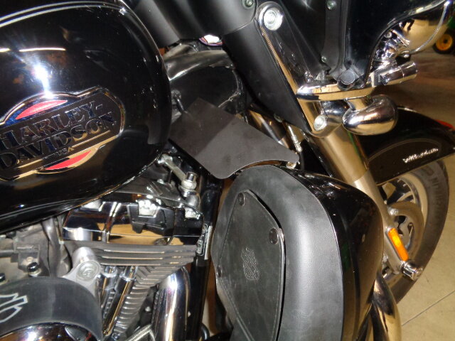

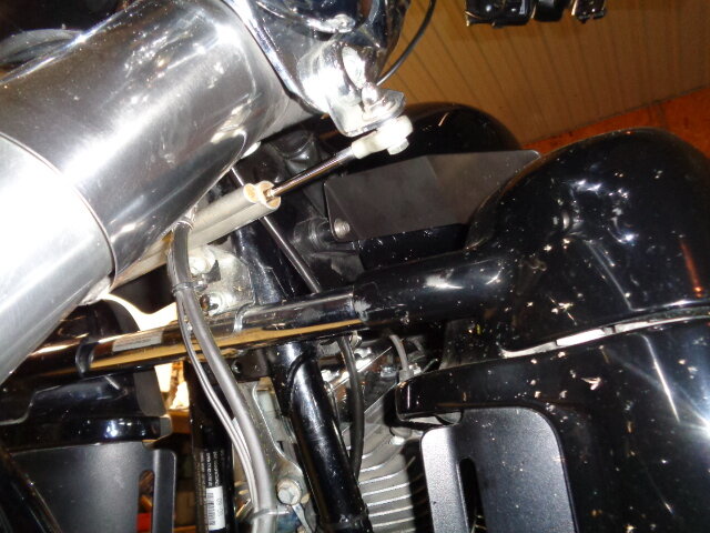

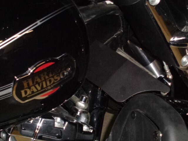

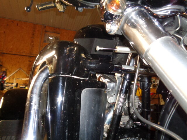

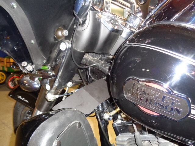

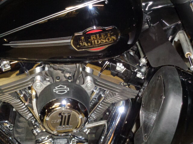

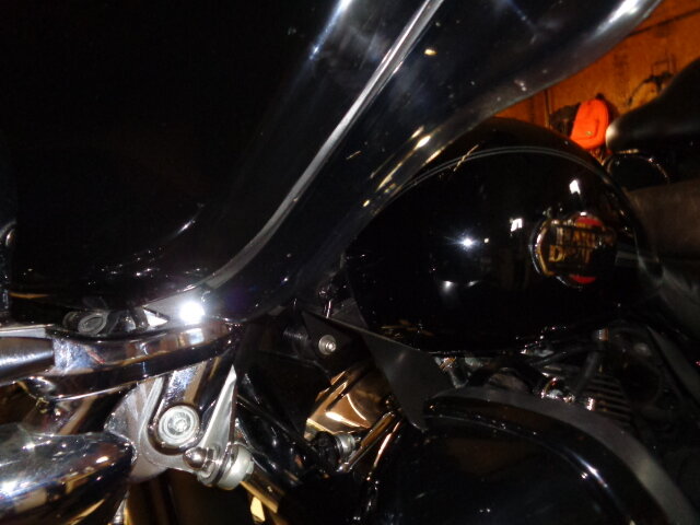

I have installed the new air deflector from DK Customs, my cylinder temps before these air deflectors was 255 to 265 on the average and even higher in stop and go traffic.:gah: After adding these air deflectors Temps dropped to 240 to 246 even lower at times and not greater than 260 in stop and go traffic. ThumbUp These should really extend the life on Old Shiney well past my years, I would recommend anyone wanting to drop engine temps give this low cost efficient modification a real go to increase the life of their machine, I know these will be on mine.ThumbUp Well done to Kevin and his group of innovative people at DK Customs for a job well done. :clapping:Travel safely fearless
P.S. Not to forget about greatly reduced air passing over the rider.

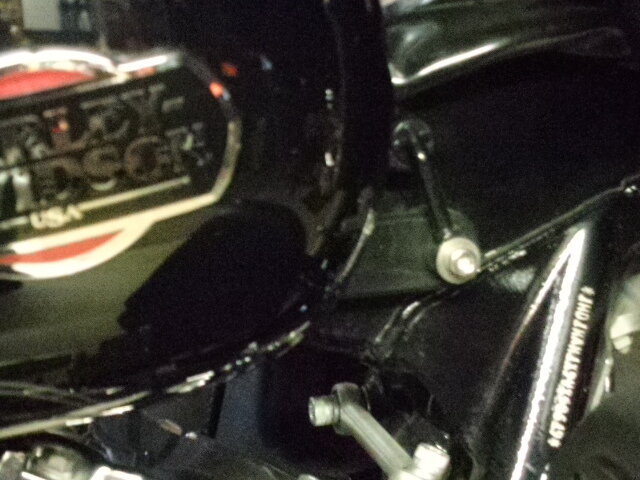

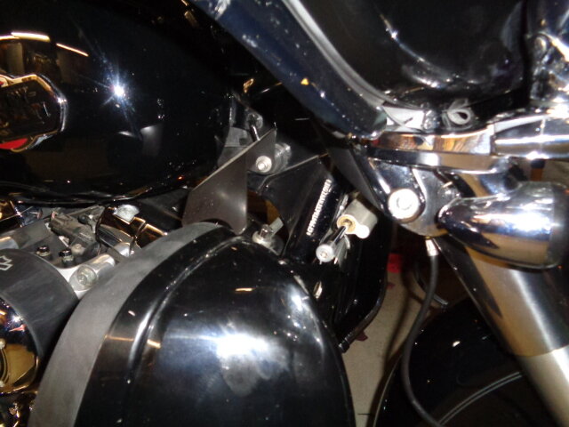

easy install
It goes on the Gas tank bolt easy to do mine were one of the first runs really tight fitting I may have to work on them in future. I could not believe my eyes watching the temps never going up. We rode an extra 50 miles or so trying to get it to change never did. I think Kevin has a great low cost upgrade on his hands. fearless
What does that attach/bolt to,Fred?

How long did it take to install the deflectors? Thanks..jc
About ten to fifteen minutes, took longer to get tools out and put back than do the wrench work. Opening and closing lowers seems to effect the heat reduction as well I really think they are a great low cost Mod. ThumbUpDSC00199.JPG ride safely fearless
About ten to fifteen minutes, took longer to get tools out and put back than do the wrench work. Opening and closing lowers seems to effect the heat reduction as well I really think they are a great low cost Mod. ThumbUp ride safely fearless
Sounds like a great Idea. I don't have the tank lift but looks like they are in the process of designing them with out the need for one.
DK! Let us know when they are ready!! Thanks - jc
