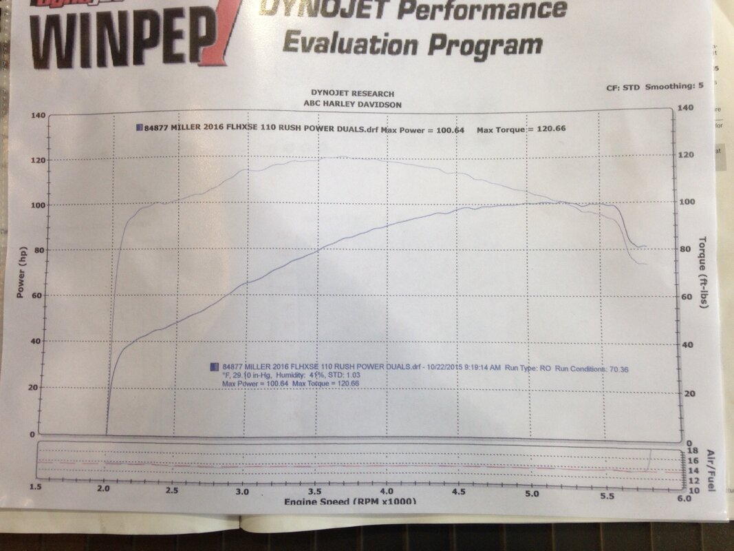

I was at the dealer today. The 110 kit comes with screaming eagle heads. I looked at the dyno chart again it 100 hp, 120 trq.

The kit PN you reference is the stock 110 kit, if you look at the little dyno chart for this kit vs the PN 92500035 Stage III kit, the Stage III kit makes more power and torque. The cams and higher compression of the Stage III kit helps make better numbers vs the lower compression and milder cam stock 110 kit, even though the stock 110 kit comes with heads. The heads of the stock 110 kit doesn't due much for it until the right cam is selected, or the heads have been ported by someone who knows how to make them shine.
On average the stock 110 will run around low to mid 90's on HP and 100 - 110ft/lbs torque. To get it into the 110 hp and 120 torque range, is going to require the right cam, exhaust, air filter, exhaust and a good tune. If someone is trying to tell you all they did was air filter, exhaust and tune to get 110/120 out of a stock 110, they're feeding you a line or they have a happy dyno.
